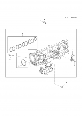

Nic tu nie widzę
1 8 49 257 55565592 KOLEKTOR SSĄCY,ZESP. 1
1 8 49 245 55571993 KOLEKTOR SSĄCY,ZESP. 1
4X 8 50 336 55580012 -ZESTAW USZCZELEK,KOLEKTOR DO GŁOWICY CYLINDRÓW 1
6 58 50 830 93179065 STOJAK (PRĘT),M8 (NR PRODUKCYJNY 12855115) 9
7 58 50 770 93177333 NAKRĘTKA SZEŚCIOKĄTNA,M8 (JNS - STOSOWAĆ 12855208 20 64 172) 9
8 20 05 360 11588714 ŚRUBA,Z ŁBEM SZEŚCIOKĄTNYM,M6 X 30 1

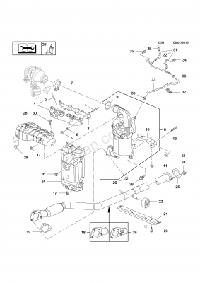

- Posty: 2212
1 8 49 234 55565984 KOLEKTOR WYDECHOWY,ZESP. (NR PRODUKCYJNY 55576346) 1
2 8 50 241 55574606 -STOJAK (PRĘT) 1
3 8 49 236 55566281 USZCZELKA,KOLEKTOR WYDECHOWY DO GŁOWICY CYLINDRÓW 1
4 8 50 932 55566152 STOJAK (PRĘT) 9
5 8 49 237 55566282 NAKRĘTKA 9
6 8 49 255 55573766 ELEMENT DYSTANSUJĄCY,OSŁONA CIEPLNA 9
7 8 50 942 55566094 KLAMRA,KONWERTER KATALITYCZNY DO WYDECHU TURBOSPRĘŻARKI 1
8 8 55 403 55574666 KATALIZATOR,ZESP.,Z FILTREM CZĄSTEK,NOWY WYMIENNY (IDENT AE) (POWRÓT RDZENIA NR 9117104 95 08 030) 1
8 8 55 490 55575978 KATALIZATOR,ZESP.,Z FILTREM CZĄSTEK,NOWY WYMIENNY (POWRÓT RDZENIA NR 9117104 95 08 030) (IDENT AAML) 1
9 58 54 986 55187584 -USZCZELKA,TURBOSPRĘŻARKA DO KONWERTORA KATALITYCZNEGO 1
10 8 00 347 55562330 -UCHWYT,WSPORNIK,KATALIZATOR 1
12 1 32 958 11514519 NAKRĘTKA,M8 2
13 8 56 081 11570204 STOJAK (PRĘT) 2
38 20 05 312 11609544 ŚRUBA,Z ŁBEM SZEŚCIOKĄTNYM 2
15 8 55 458 55562332 OSŁONA,TERMICZNA,KATALIZATOR 1
16 8 52 735 11519374 ŚRUBA,Z ŁBEM SZEŚCIOKĄTNYM,M6 X 12 5
17 48 06 090 11609411 NAKRĘTKA SZEŚCIOKĄTNA,M6 2
18 8 54 470 93168450 RURA WYDECHOWA,ZESP.,PRZEDNIA (IDENT AAGG) (Z WYJĄTKIEM POC AUQ,ZMIANA PRODUKCYJNA DLA ROKU MODELOWEGO13.5) 1
39 8 54 639 95515293 RURA WYDECHOWA,ZESP.,PRZEDNIA 1
19 58 54 472 13255811 USZCZELNIENIE,PRZEDNIA CZĘŚĆ RURY WYDECHOWEJ DO KATALIZATORA 1
20 20 66 102 11102751 NAKRĘTKA SZEŚCIOKĄTNA,M8 3
21 8 56 080 13258290 WSPORNIK,PRZEDNIA CZĘŚĆ RURY WYDECHOWEJ 1
22 8 56 423 13229780 PIERŚCIEŃ AMORTYZUJĄCY,ZAWIESZENIE RURY WYDECHOWEJ,PRZEDNI(-A,-E) 2
23 48 05 790 11588723 ŚRUBA,Z ŁBEM SZEŚCIOKĄTNYM,M8 X 25 2
24 20 66 015 11516076 NAKRĘTKA,M8 2
25 8 54 515 13229872 USZCZELNIENIE,PRZEDNIA DO ŚRODKOWEJ CZĘŚCI RURY 1
26 19 48 569 90513210 PASTA MOCUJĄCA,WEICON ANTI-SEIZE,120 GRAMÓW AR
28 8 60 218 55572583 OSŁONA,OCHRONNA 1
29 12 87 002 93181957 ŚRUBA,Z ŁBEM SZEŚCIOKĄTNYM,M6 X 10 (JNS - STOSOWAĆ 12855384 58 60 948) 1
30 20 00 370 11588712 ŚRUBA,Z ŁBEM SZEŚCIOKĄTNYM,M6 X 20 2
31 8 62 042 55566128 RURA,ZESP.,CZUJNIK RÓŻNICY CIŚNIEŃ WYDECHU 1
